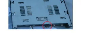

    Hi i have need to bought for my carthago Malibu 32.2 a connector female for the receveir kathrein hdp 170 like in pictures
    Anyone can you tell me the name in deutch or the link ....

    Hi Massimo,
    in the operating manual for the hdp 170 I see that this is the power connector.
    The connector itself looks very unusual to me. It might not be available separately.
    I would try to get the complete power cable from Kathrein as a spare part -
    even if you only use the connector in the end.

    Hi Massimo,
    the manual for the hdp 170 - unfortunately only in german - ist here : https://www.kathrein.de/fileadmin/medi…se/9362190a.pdf
    Tobi was absolutely right, the connection you mentioned is the power-connection, see page 6 of the manual. The german word for the cable is "STROMANSCHLUSSKABEL".

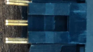

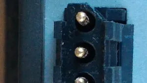

  • uass222
    13
    • 25. Juli 2017 um 16:36
    Hi
    i show you anotrhers pictures of the plug...
    Danke

  • uass222
    13
    • 25. Juli 2017 um 16:39
    Another...
    danke

    • 27. Juli 2017 um 16:54
    Hi again,
    as I said in my first post. The connector looks very unusual to me.
    The typical suppliers I would look at will not have this listed.
    What is the diameter of the contact pins? If it were around 4mm maybe you could use
    female banana plugs (3pcs) like this one here.
    That's not a very clean solution, though.
